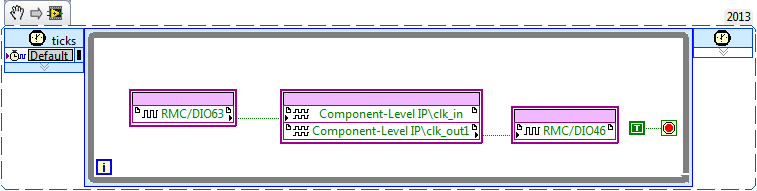

Hello, I have an sbRIO board and i want to pass a clock through FPGA from one pin to another. I'm routed a clock to port, say DI (DIO63) and expecting it on another port, say DO (DIO46).

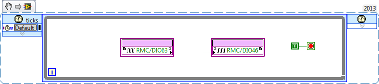

If a use direct connection of one DIO to another in an sctl (all DIOs are configured with 0 synchronization registers for write and read) clock is passing normally and I see it on DO:
Now I want to use a clip for this task. I've created a basic vhdl file:

Imported it to project using Component-level IP wizard (see below) with default configs and dropped it do diagram:

This implementation is running, BUT I do not see any activity on DO (all DIOs are configured with 0 synchronization registers for write and read). What's the problem? What do i need to add/remove/change in a vhdl file and overall clip to make it work?

Hi Konstantin,
There are a couple of things that jump out at me with your LabVIEW FPGA code.  You mentioned that you set the synchronization registers to 0 for the DIO, but you didn't mention doing this for the CLIP.  I would recommend setting the synchronization registers to 0 for the CLIP as well.  You can access this option by right-clicking the CLIP in the Project Explorer window and selecting Properties.
Another thing that jumps out at me is that you have a True constant wired to the Conditional Terminal.  I would recommend using a False constant instead of a True so that the loop runs more than one time.
I believe the combination of these things is causing your issue. Since the loop only runs once then there aren't enough iterations for the signal to get through the synchronization register.  We have run your CLIP on a device here and we don't encounter the problem when changing these two things.

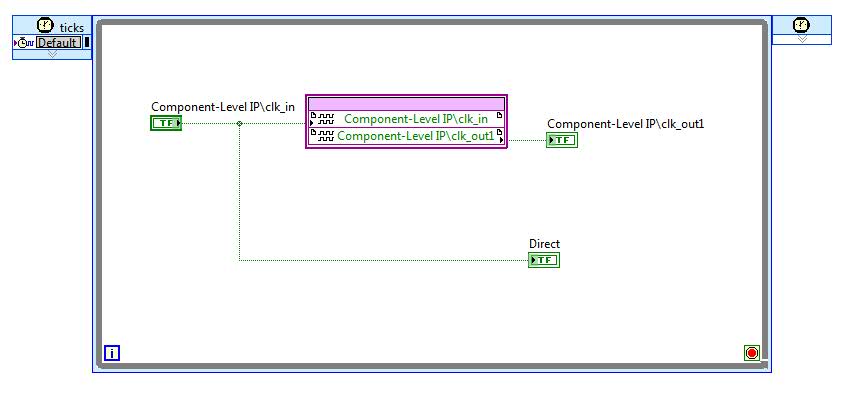

We often find it helpful to use controls and indicators for troubleshooting purposes with CLIP.  We used the VI shown in the picture below to initially trouble shoot your CLIP.

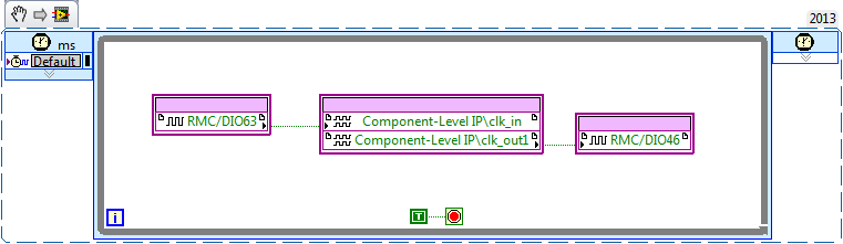

Now lets move the code above out of the SCTL:
When the synchronizing registers of output enable for our DIOs is 1 the code works an interesting way: we will see logic low or logic high on DIO46 from one load to another load of a bitstream (or system reset). When the synchronizing registers of output enable for our DIOs is 0 the code won't work at all: we will observe a logic low on DIO46 always.

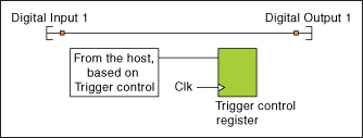

2) Why do we need an SCTL running ONE iteration to make code with a CLIP work and why code with a CLIP outside and SCTL won't work properly? if we have zero triggers on digital path:
we do not need any iterations to pass a signal form input to ouput only routing delays will arise

This code is bending the rules of dataflow.  The code is written more as if it were a hardware schematic rather than using a dataflow paradigm.  Normally, LabVIEW code outside of a loop would only execute once, synchronous with the block diagram clock. Removing the synchronization registers should allow this code to 'continuously' execute asynchronous to the diagram, but this isn't the standard way of developing LabVIEW FPGA code.
What is driving the need to write this code outside of a single-cycle timed loop?  It is difficult/impossible to compile your CLIP block at 40MHz?
Regarding suggestions, I have seen some similar behavior in the past with code like this and it had to do with the "Set Output Enable" method, similar to the path that you and Joshua are exploring.  I would suggest explicitly setting the output enable method to TRUE and using dataflow to ensure this method is set true 'before' the asynchronous section of code.  As you probably know, using the DIO output IO node will normally assert the output enable and drive the pin to the level input from the LabVIEW diagram. As you suspected, I also suspect the lack of synchronization registers to the IOBuffer is causing a problem with consistently setting output enable line to the buffer.
