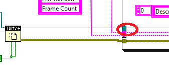

I have actually replicated the problem. The error code is documented here and I particularly noticed the line in the link "an object in LabVIEW such as a wire or a loop tunnel does not pass an internal test"
I found that although I could run the VI, if I removed the redundant loop tunnel in the image below (there are two refnum tunnels on top of each other), and then undid the removal, when I ran it again labview produced the same error for me and crashed.
So to solve it, I think if you just remove the redundant tunnel (there is an output tunnel on top of an input tunnel, I'm sure from just a misclick) and resave the VI, it should not crash any more. Make sure you don't undo the change!

Thanks for your reply. I did notice the tunnel and removed it. This had no change on the error.  I also followed the debug instructions on the KB link and had no resolution. Do you have any other ideas ?
