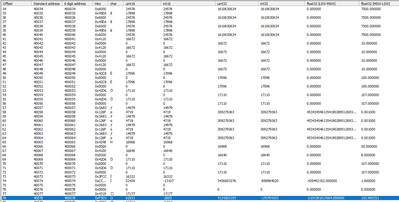

These are the values I'm trying to read.  I rewrote the code using NI modbus library.  I am getting values but they are not the values I want.  They are the Uint16 values and I need the floating 32 values.  I am having no luck converting them from 16 to 32.  Is there any simple code that can run to convert those values?
(4,750 Views)
You could also typecast an array of U16 values into an array of single floating points in the event you have registers in a row you have acquired as an array to convert.
You could also typecast an array of U16 (with only two elements) in to a single floating point.
You may have to play around as the word order may matter.
Useful functions will be under the Numeric >> Data Manipulation palette.
