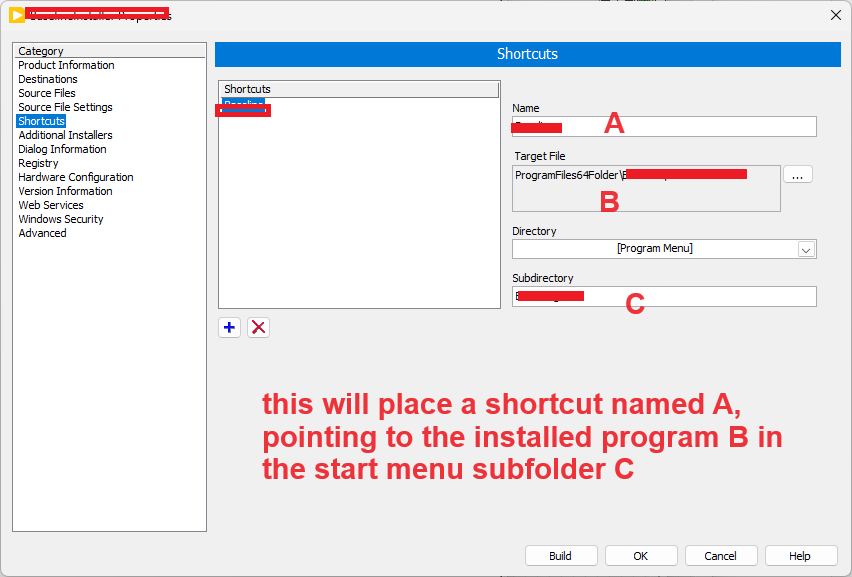

This is what my installer looks like
(1,555 Views)
