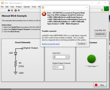

I'm trying to run the simple Labview LINX example at the NI companion site, https://www.labviewmakerhub.com/doku.php?id=learn:tutorials:libraries:linx:sparkfun_inventors_kit:se...

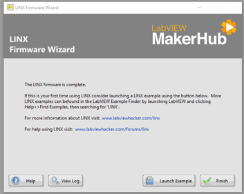

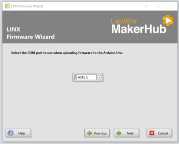

I have Labview 2018 64bit on Windows, LINX (via VIPM), and an Arduino UNO connected via USB.  When I try to upload firmware to the Arduino Uno, the menu says "success" but the Arduino is then unresponsive in the button push demo.  Related, the "refresh" button in the Firmware Uploader does not list any Arduino as connected to a USB port and I have to manually type in COM11).
The Labview LINX/Makerhub instructions suggest that NI VISA 14 should be installed, but this download link (from Makerhub) seems to be broken? http://ftp.ni.com/support/softlib/visa/NI-VISA/14.0/Windows/NIVISA1400full.exe
So:
1. "NI VISA 14" - is this what I should be installing to support LINX?  Is the broken/stalled download link a known problem?
2. In Labview LINX, what should I be doing (or what error am I making) if the Arduino/LINX resource hardware doesn't show up in the list of available Serial/COM ports?  (All I see is ASRL1:)
 Thanks!

Update, installing NI VISA 18.5 partially resolved the error.  The Arduino at COM11 now shows up. Demo program still doesn't work though...
