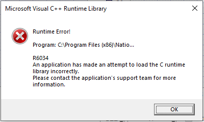

Labview + Python = Runtime Error R6034
Each time I call a Python script from LabView the following error prompts. After pressing ok the python script runs without any problems and labview as well.
The LabView runtime engine is the 2018 32-bit, Python called is 2.7, Windows 10 64 bit
Do you know how to correct the error?

I had the same problem last week using a Labview Application in a computer of our labs. After debuging this problem, I could realize that the Python script of this App used several modules that in my computer (Development Mode) have a newer version as the installed modules in the computer of our lab. I made a little program with the Python Node and a Python-test script in it only with the sections of imports. After commenting several lines of this test script I could find that the problem came when I imported the "pandas" module. I just make an update of this module and then all was solved.
