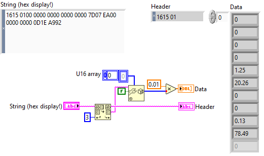

Hi luka,
I guess you receive a string, which is shown hex-formatted in your message:
Just two functions to get an array of integer values!
I also guess you can do the scaling to 0.01% on your own…

See if this can give you some ideas.
We don't really know if negative values are allowed (gas percentages are typically not negative...:) ) . If so, the empty array constant array should be I16. Check the documentation. The reason I also show the header output is because you might actually want to validate the header and generate an error if it differs from the expected value (not shown).

This is what I was looking for. Thank you!
It seems you already figured it out, but by first 6 digits and last 2 digits, I meant the first 6 and last 2 characters in the output string. In this case,  "1615 01" and "92". Also, you are correct in that negative numbers are not allowed.

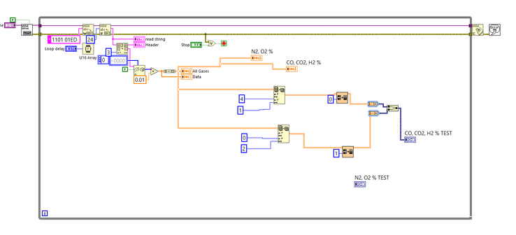

This is the best solution that I have right now, but it still does not work as I need it to:
It takes the original array as an input and grabs index 4 (H2), and index 0 (CO) & 1 (CO2) and outputs them as 2D sub arrays. I can only read the first two gas values (H2 & CO2) in the digital display, and it does not plot anything. I'm not sure if I even need the sort 2D array function, but it works better than anything else right now. Maybe I should separate each of the 3 gases into their own sub array, sort, and graph?

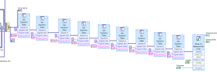

I will also need to export and save these values into an excel file. When I was using the usb-6008 daq module and daq assistant function, I was able to split the signals and export to excel like this:
It does not seem like this will work for the array values. What is the recommended way to do this?
Why do you use the 2D array for all those "grab index" purposes?
Why not use the "original" 1D array???
Why use those Sort functions when you want to index an element from your array - there's a function called "IndexArray"!?
Why do you use ExpressVIs again to build a graph? Why not use BuildArray as you should have learned by now???
Did you learn the basics of array handling in LabVIEW yet?
Simple programming rule (not just for LabVIEW): whenever you need to repeat an operation you should use a loop!
Why don't you use a loop (with a shift register) to set the signal properties???
But:
  • Why don't you define the signals "correctly" for your DAQmx task? That's the place where you define the signal name! No need to do this again and again when trying to save data to a file!
  • Again: get rid of all those ExpressVIs and DDT wires! Use the waveforms provided by DAQmxRead!
