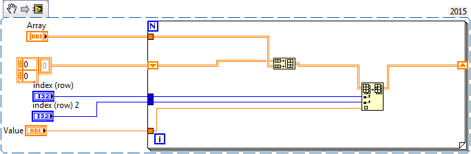

Resembles like this!

Please leave out that Build Array stuff... that makes no sense but eventually gets you an out-of-memory error killing your application.
