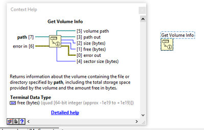

wiebe@CARYA  ha scritto:
Ah, it's so simple... I never used this function.
I gave confidence to the OP claim (that there is no solution available) but I should have not.

@LamarDavisss  ha scritto:
Man instead of making fun of me try helping. We do not have full development version of labview accessible to us. We get hardly 1 hr to use labview in our institute. Thanks for your reply anyways. This vi returns size of only 1 disk.
Believe me, I tried to help, but I should have given a check to the Advanced File Functions palette before. My bad.

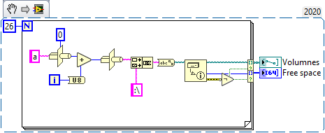

Put the function in a loop and loop over each letter:
Message 8 of 14
(4,401 Views)
Thats look great. Thank you so much for your contribution.
