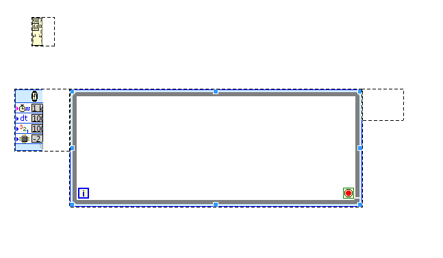

I have been working on a rather large top-level vi for quite a while when suddenly several system vi's have developed display problems.  In particular, all vis from the FPGA module no longer appear on the block diagram.  They are there, because I can move them, set properties and wire to them, but they are invisible.  Even if I add a new one from menu, it is invisible.  The same is true for the controls block on the timed loop structure.  The loop is visible, but the controls are not.
I attached an image of part of the vi which shows what should be an "open FPGA reference" and a timed loop.  As you can see, the wire are connected, and it compiles and runs fine, but there is nothing on the screen
It is specific to this vi.  If I create a new vi and add the same vi's they look fine.  As far as I know, I did not make any changes to any display settings.

Are you around or past the 16000 pixels from the origin?  If so than this is a known bug (CAR 188360).  There is no workaround other than not working past this threshold.  This doesn't occur on all VIs rather certain VIs that use an internal development framework.  Examples of these are FPGA references, Timed Loop Terminals, Database Variant to Data and Match Regular Expression.
I should note that this doesn't affect execution.

My block diagram is not terribly large, but how do I know:
where the origin is?
how many pixels I am away from it?
I recently had a vi become unusable (had to revert to previous day's backup because it could not be recovered) because the front panel had "insane objects" on it due to them being placed beyond some limit (by the way, they were placed outside of the limits automatically by labview when I pasted a local variable on the block diagram, but that is a different thread... http://forums.ni.com/ni/board/message?board.id=170&message.id=476312&query.id=3236271#M476312).
But my current vi has a very compact front panel (through use of a tab control) and the block diagram is roughly 4000 x 3600 pixels (based on counting the screen grids)
The only vi's that I am using that are having problems are the FPGA module and the timed loops.  I was not using it,  but now that you mentioned "match regular expression"  I placed that on the block diagram and it was invisible as well.
If I can find the origin and move everything towards it will my vi be healed or am I going to have to redraw it?

You should be able to get a global position by moving the either of the scrollbars.  When you click or drag the scroll bar a small box should appear (right of the cleanup button if the BD is maximized or below the horizontal scrollbar if the BD is not maximized) giving the global coordinates.  If you notice you are outside about 15000 pixels (I'm not sure if this is a hard cutoff) try moving everything closer to the origin.
You shouldn't have to recreate anything.  You actuall can find the line where the icons become visible.  In a quick test here it looked to be about 15000 pixels.

I found that although my diagram was only 4000x4000 pixels, it was located somewhere out at -19000 x -8000.  moving it to the origin magically healed my poor icons.
It may be worth noting to the developers that I got into this mess by using the diagram cleanup function quite extensively.  Now that I know about the origin, I can see that when I use cleanup on the entire diagram it tends to migrate in the negative direction.  I started my diagram at the origin, but as I worked on it and periodically cleaned it up I did not notice that it was slowly crawling away.
