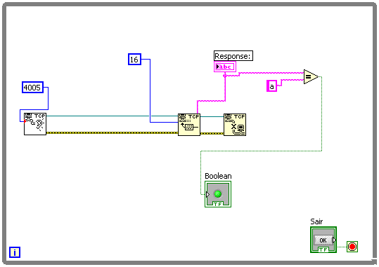

Hello, in this moment i did an example that read value of string labview from PHP.
Now, i need send data from php tolabview but i don´t could makethis... I´ve this schema on labview:
In PHP i´ve this:

Hello, it work! I changed the number of bytes that TCP READ read. When string is equals "a", it set led to true:
PHP Code:

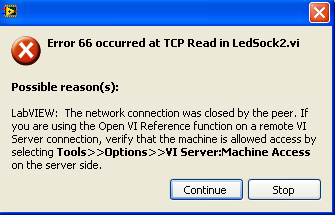

But now, a get this error when TCP close:
But i don´t understand because i´ve defined my IP in VI Server:Machine Access .
Any idea?

Hello Islero, you need to do a VI as image of my last post and you can use the PHP code.
Just change lenght of the String received on VI, for example if you send a string with "a" change value 16 to 1.

Hey Pedro,
I'm using Apache, PHP 5.3 and LabVIEW 2009. I'm doing mostly the same thing you are and have it working, but then again you do too. Error 66 means the client closed the connection, which is what you want. So in your LabVIEW code, you can watch for error 66 and filter it out because it means everything worked well (the PHP script called socket_close or exited).
