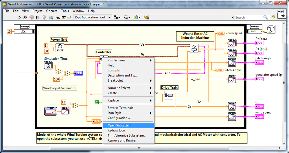

That is hard for me to say as I don't know your background. There are many tools and libraries available within LabVIEW Control Design and Simulation that can help you build a model within LabVIEW. There are two main ways to build your model:
1) Implement the calculations manually. If you can write out your microgrid model as a set of differential equations, you can simply use basic math operations (multiply, divide, add, etc) to calculate each dx/dt and then use the Integration block (part of Control Design and Sim palette) to integrate and get 'x' for each state.
2) Build a state space matrix for the microgrid, then use the State Space VI to implement the model (located on the palette under Control & Simulation -> Simulation -> Continuous Linear Systems -> State Space.vi).
There are also some examples built into LabVIEW to get you started. In LabVIEW, go to Help -> Find Examples to open the example finder. Check out these two examples:
- Control and Simulation -> Simulation -> Controllers -> SimEx DC Motor Position Control with PID.vi
- Control and Simulation -> Case Studies -> Electrical Machines -> Wind Turbine with DFIG - Wind Power Limitation.vi.
Both of these VIs should give you an idea of how you can build your models. Note that in the Wind Turbine example they have nicely packaged up their models into "subsystems", which are really just sub VIs. To open a subsystem right click on it and select "Open Subsystem". See picture below:
