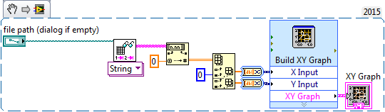

Try this

Hey Palanivel,
Thanks again for the help, I maanged to recostruct your vi and mine by linking the file path dialog together to form as set.
It works perfectly(I think lol) and now I have the following issues.
1)I have to plot out the histogram of the 3 XY Graphs you have helped me with.
2)I have to collect the exact data out and fill it up to the tank to show the actual amount for C, G and D

2) From the text file data obtained, so for example the data shows the 3 columns which is C,G and D values. the values have to be filled up to the tank.

The Slider/tank expects Scalar value but the data from file is an array, how do you map an array as an input to a scalar terminal?

Sorry for the late reply Palanivel,
I think I have to consult my team for this part...
As for 1) as mentioned earlier, should I use the "Build XY-graph" function to link all 3 data to form a "Create Histogram?"
