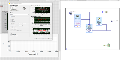

I am having trouble understanding spectral measurements. As far i know,i have a raw data input of Voltage to time from 2 microphones and it performs FFTs so that the X-axis is in the frequency domain. However, i am very confused as to what the Y-axis represents and its units. I have been told various things that the Y-axis is SPL in decibels and PSD in Pa/Hz or dB/Hz. I am just generally confused about the Y-axis. I also have an amplifier of gain 100mV/Pa and i am struggling to see how i can incorporate this in calculations. I am trying to achieve a graph of SPL (dB) to Frequency or PSD (dB/Hz) to frequency. What is on my Y-axis when i have Magnitude(Peak) as my selected measurement and dB as my result? What is on my Y-axis when i have Power Spectral Density as my selected measurement and dB as my result? Here is my VI. https://i.imgur.com/J4GOoMm.png

If you acquire in Volts, then the Y-axis is going to be in volts.  Though the Y axis of an FFT might be volts, or a unit of power or something like that depending on the exact version of FFT you are using.
If you want to convert to Pa and you have 100 mV/Pa, then divide the incoming signal by 0.1 to get the signal in Pascal.

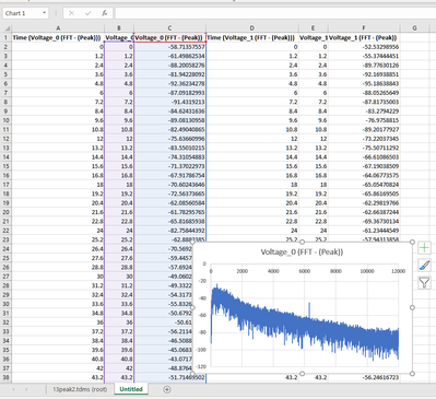

Can you tell me what would be on my Y-axis if i had the selected measure as Peak magnitude and the result as dB? Do these settings not matter and the y-axis be Voltage regardless? And the difference between the selected measurement being Peak measurement and power spectral density as from the data i have collected, there seems to be little to no difference in the plots.

I have a raw signal input of voltage to time from 2 microphones which i am feeding through the spectral measurements express VI. The selected measurement is Peak Magnitude with the result set as dB. I am confused as to what the y-axis of the graph represents as i have been told different things. I have beem told that it is sound pressure level in dB amd that it is still voltage. Can someone clarify what the Y-axis represents and the units?

Can anyone tell me what i am plotting? I think it is Power in dB but i am unsure. I have a raw signal of voltage/time run through the spectral measurements VI, performing FFTs to put it in the frequency domain but i am unsure of the what is on the y-axis and the units. I have the selected measurement as peak magnitude and the result as dB.

Yes it is dB.
