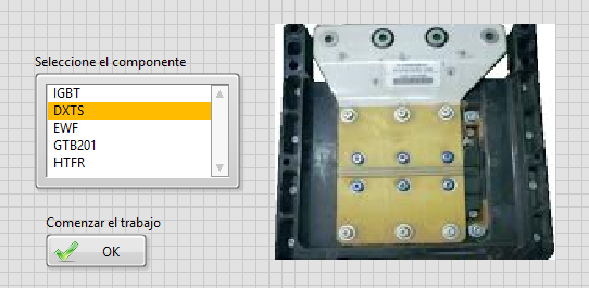

So what I need to do is an interface where the operator chooses from a list the component that he's going to make the work (when he clicks on the name in the listbox, it should appear a photo of the component so he's sure that that´s the one). Then he chooses to start the job. The front panel changes to show the component with LEDs instead of the screws, to show the sequence of the fastening (the LED1 starts turned on, then after the operator makes the fastening it turns off and the LED2 turns on, and so on until he finishes all the sequence). It also has an indicator to show the torque being applied, and two LEDs to show if the fastening was OK or No-Good.
