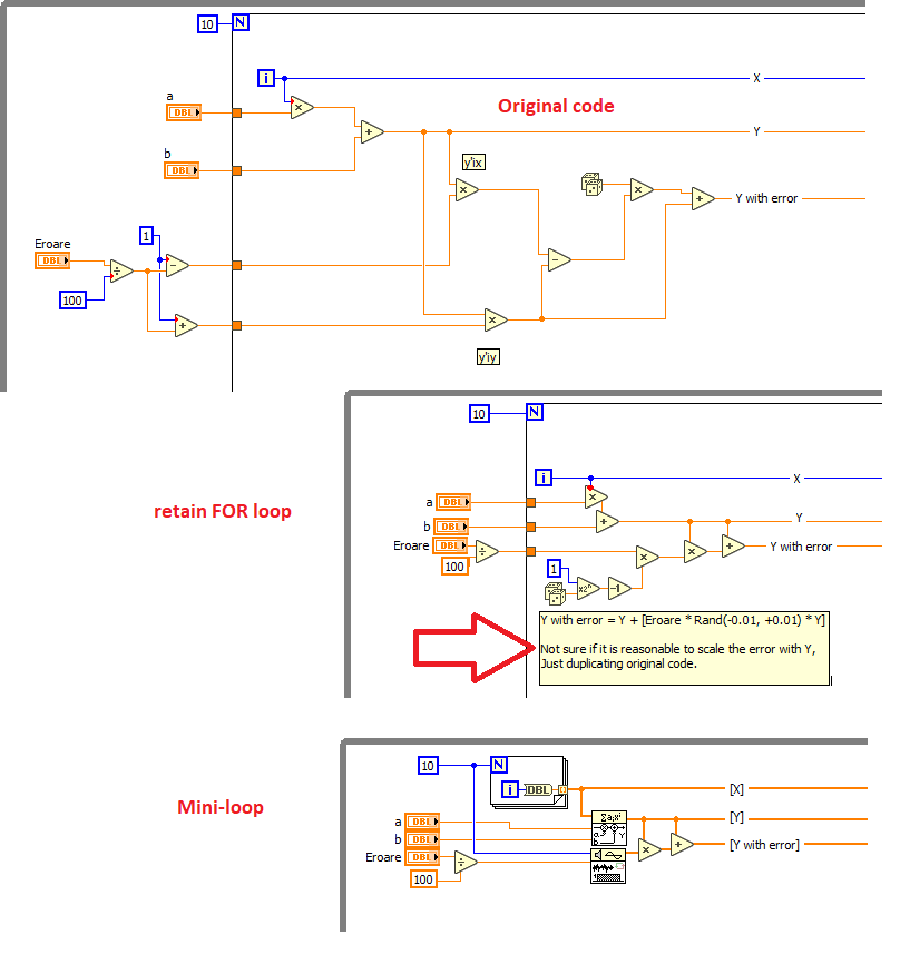

  • You swapped the definition of "ideal" (contains noise) and experiemental" (contains no noise).
  • Equal distributed noise is not realistic. Noise is typically Gaussian.
  • Your scaling the error with Y. Is that really realistic? (i.e. no error if y=0)
  • Even if you really want an even noise distribution, your code is pure Rube Goldberg.
  • Please don't maximize the front panel to the screen. That's extremely annoying!
  • Did you even look at my example code? Did you understand it?
Here are some alternative code version that duplicate your weird nose generation.
Message 12 of 13
(719 Views)
This is how we learnt în university, we haven't learned the more complex functions yet.
