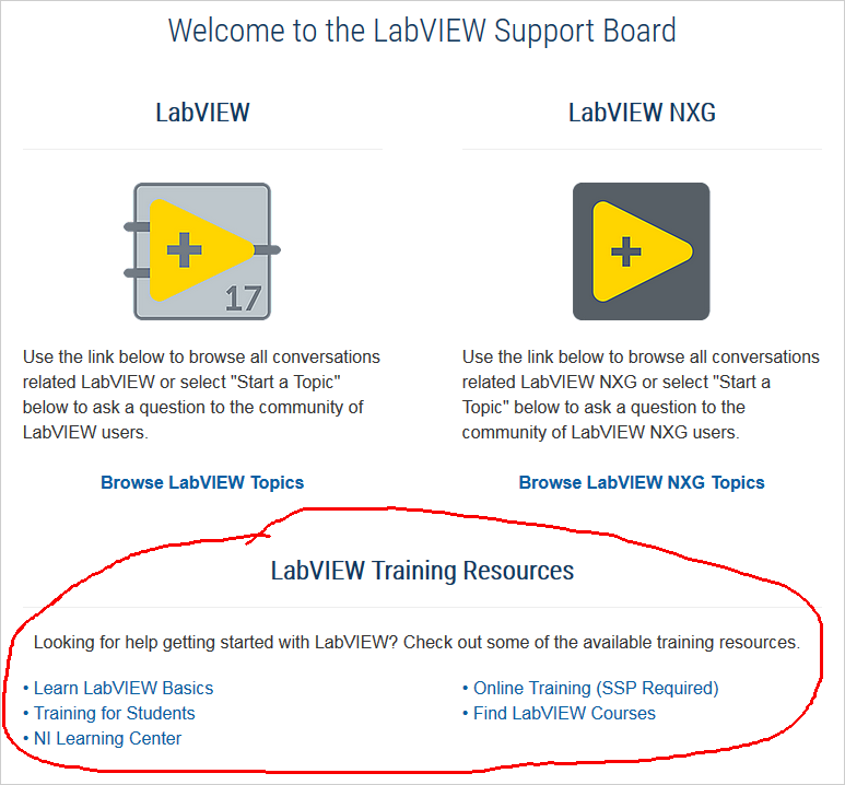

Hi AnandR,
did you notice those "LabVIEW Training Resources" on top of the LabVIEW board?
Isn't this what you are asking for?

Hi GerdW,
I checked now but couldn't find it. Can you please send me snapshot of what you are referring.

Hi AnandR,
I suggested this one:
Here you will find training lessons to learn LabVIEW!
A suggestion: forget about C programming (including variables) and learn to THINK DATAFLOW! 😄
