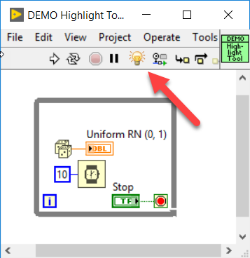

Just in case you don't know what it means to Highlight Execution, this picture shows where you can turn it On (illustrated) or Off.  When you run with it turned On, you'll be able to "see" the data flowing through the wires.
Highlight Execution Tool (On)Highlight Execution Tool (On)
