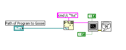

OK, I got it to work by getting rid of "start" in the input command. Also, you should add code to put quotes around the filename. It may work on your computer, then your customer gives it a path that has a space and windows will return an error. I don't have LV 6.0 so I can't save it for you, but here's a picture.

I made the changes, and it seems to work. I'm going to go test it. Thank you.
