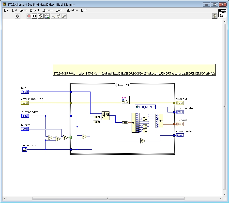

Accepted by topic author btbradj
I have resolved the issue by taking care of the buffer bookkeeping directly in LabVIEW rather than in C. I couldn't even rely on DSNewPtr to leave things in the correct place and was still getting handle leaks. Just in case anyone is interested - solution is below:
Message 20 of 21
