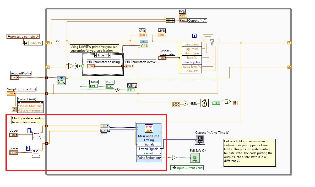

I believe the issue is that you do not have enough datapoints defining your upper and lower limits.  You only placed coordinates for the vertices of each trapezoid.  The Mask and Limit Testing VI will not automatically generate datapoints between these points it needs a full set of datapoints defining the whole graph.
Your input data has much more datapoints than the actual boundary you've defined, that's why it appears as a line at y = 0.  It plots four points on a chart that probably that has much more data points on the input.  You should generate trapezoidal signals and wire those signals into the upper and lower limit inputs of the express VI.  That way you do not have to fill out all the datapoints manually.
Below I've attached an example LabVIEW project that shows how to do this.  I used this example to create a subVI to generate a trapezoidal signal.  It uses ramp functions to piece together an array of datapoints that looks like a trapezoid.
I think you should use the "Generate Trapezoid" subVI I included in my project.  Generate the upper and lower trapezoids outside the while loop with the same amount of datapoints as you expect from your input data.  This should save processing so you don't have to generate the waveform each loop iteration.  It will look something like this:
