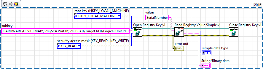

Accepted by topic author LeeBowers1
an example of getting the serial number of the disk,
i can make no guarantee, that the subkey will not be different on varying systems.
you will have to hardcode the serial number in your code distribution
If Tetris has taught me anything, it's errors pile up and accomplishments disappear.
