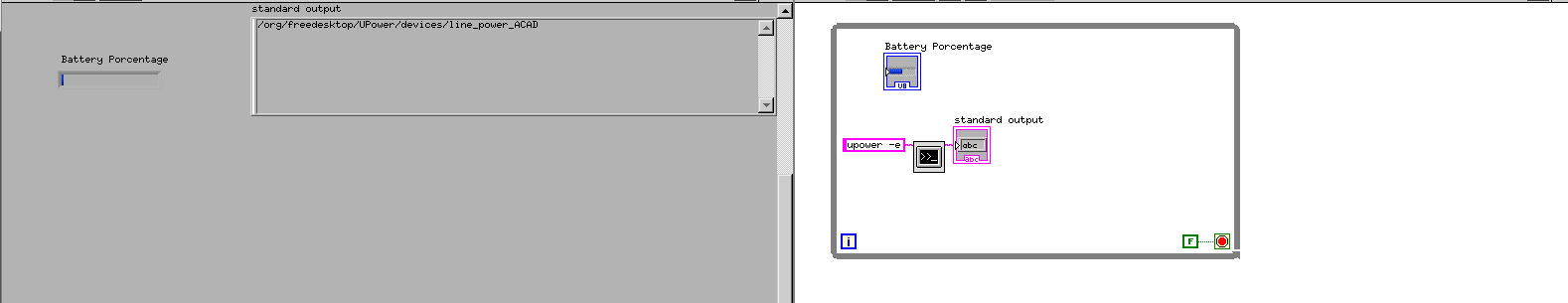

I used the command upwoer -e in the system exec vi, and I didn't get the information that you told me I would get.
Can someone please tell me how to fix this?
Thanks.

Well upower -e will give you a list of devices it knows about. In your case there only seems to be one device. Parse that output into lines and then you can use each line as parameter to upower -i <your device name>. there are many man pages about upower so it's a good idea to google for that and learn from there. This is not a LabVIEW problem but simply Linux knowledge.

As said,
The upower -e command outputs a list of devices, you must use that output as a parameter of the upower command to get the battery information.
