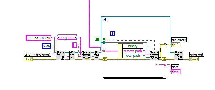

We are in the process of switching from PharLap to Linux RT. For legacy reasons we need the RT Application to pull files from from a remote ftp server (about 300-400 files. around 50 MB total).
The transfer is using active transfer mode on purpose since we can't open any more ports in the customers firewall. As far as I know pharlap doesn't use a firewall anyway so thats the obvious choice here.
The process has been working fine for the last couple of years. The same exact code behaves very inconsistent on linux rt so there are multiple outcomes:
1. The transfer finishes just fine.
2. A random number of files is transfered and the transfer suddenly stops. About a minute later it returns with error 425 "Can't Open Data Connection". The current file is skipped. Now the transfer either finishes or it gets stuck at another random file, which is again skipped with error 425. This is repeated until the list of files is finished.
The FTP Server is the built in IIS running on Windows 10.
I can't wrap my head around about what is actually happening here. So far I've tried:
- Using different ports. No Change
- Switching to passive mode. Works fine as long as I open the firewall for the set passive range. Which i can't do on the customers network
- Using a different FTP Server (Quick ‘n Easy FTP Server Lite) same port. Works fine. Not feasible on the customers site either.
- Using different clients to download the exact same files to my work machine. Works fine.
iptables -L on the RT Target is set to accept on all chains. Therefore iam guesing everything is open as well.
Any help would be apprceciated.

Thank you for the suggestion. Unfortunately I already tried this after noticing the file transfer on linux (when it worked) was way faster than on pharlap. I've tried up to 1s delay. No change in behaviour.
Even reducing the number of files doesn't help. 10 files and a couple of retries is enough to trigger this.

I can't zip the files from the rt side. I also tried to open/close a new session for every single file. It still occurs sooner or later.
I am still not sure which side is causing the problem here.
