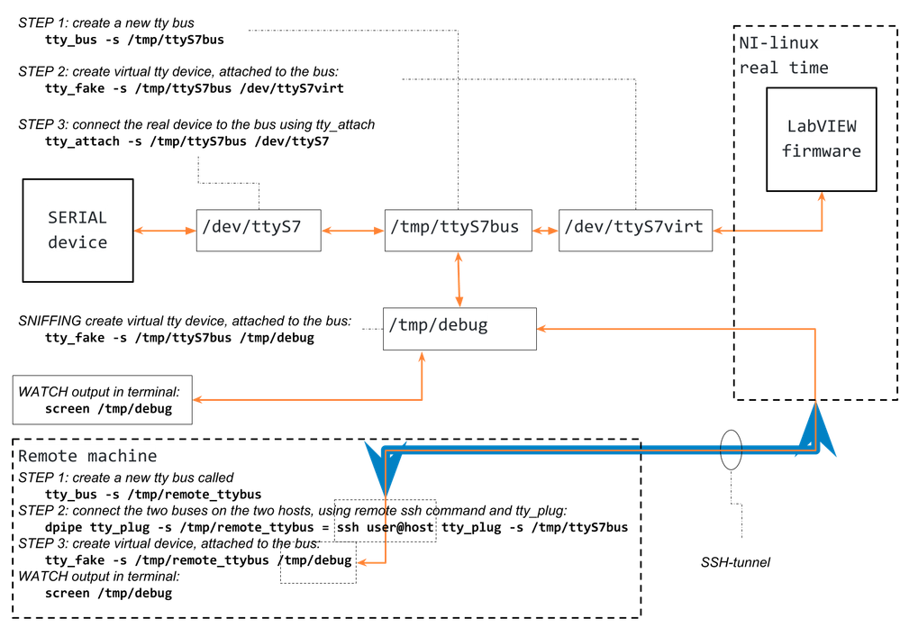

In-case anyone else bumps into this thread for solutions...
I have recently discovered ttybus.
Here is a sketch of how it works and may be used:
ttybus generic.pngHere are the commands for copy paste:
Spoiler
# STEP 1: create a new tty bus
tty_bus -s /tmp/ttyS7bus
# STEP 2: create virtual tty device, attached to the bus:
tty_fake -s /tmp/ttyS7bus /dev/ttyS7virt
# STEP 3: connect the real device to the bus using tty_attach
tty_attach -s /tmp/ttyS7bus /dev/ttyS7
# SNIFFING create virtual tty device, attached to the bus:
tty_fake -s /tmp/ttyS7bus /tmp/debug
# WATCH output in terminal:
screen /tmp/debug
## Remote machine
# STEP 1: create a new tty bus called
tty_bus -s /tmp/remote_ttybus
# STEP 2: connect the two buses on the two hosts, using remote ssh command and tty_plug:
dpipe tty_plug -s /tmp/remote_ttybus = ssh user@host tty_plug -s /tmp/ttyS7bus
# STEP 3: create virtual device, attached to the bus:
tty_fake -s /tmp/remote_ttybus /tmp/debug
screen /tmp/debug
ttybus binaries for sbRIO-9627 are attached.
