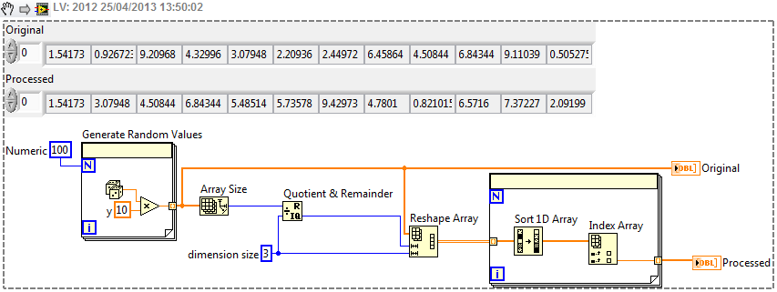

I am not sure if I understood you correctly. Is this what you are looking for?

jack_black wrote:
Create a program that will examine the control of the application of one-dimensional numerical values in the table. The first time the table is reviewed first 3 value. They are arranged in order and the order of the middle exported formed in the indicator table in the first item. The next time, first examined embryos to be dropped off and was replaced into the control table the fourth value. Place the numbers in ascending order and exported to the middle value of the indicator table, the second value. The procedure is repeated for as long as possible.
You need to rephrase that!
A table is always two dimensional. Do you mean a 1D array?
Do you want to retain the median of groups of three and place it in a new array that is 3x smaller?
I don't understand the connection with the embryos? Did google translate add that?
Can you create a small example with some typical input and the output you would expect from it?

yes it translated because my english skills sucks 😞
A table is always two dimensional. Do you mean a 1D array? YES
Do you want to retain the median of groups of three and place it in a new array that is 3x smaller? NO
at first  we take three numbers from beggining of the table and put them smallest to biggest and middle one takes to indicatortable first embryo(cyema, element, embryo, entry, germ, member, node, spore)
I don't understand the connection with the embryos? Did google translate add that? yes its translated 😞
