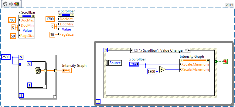

Not sure what you mean by "make selection and draw frames with legend " but it seems the timely scrolling of the graph is more the issue.
This snippet takes 2500x2500 random numbers and plots them in an intensity graph with a visible XY range of 1800x800 (trying to approximate your conditions).  The scroll bars are handled by the event structure and seem to be much more responsive than 100ms per scroll event.  I made some assumptions in the program as some of the details were not covered by your description.  Does this do what you need with respect to redraw times?
If I'm missing the boat, please post your (slow, non .NET) code.

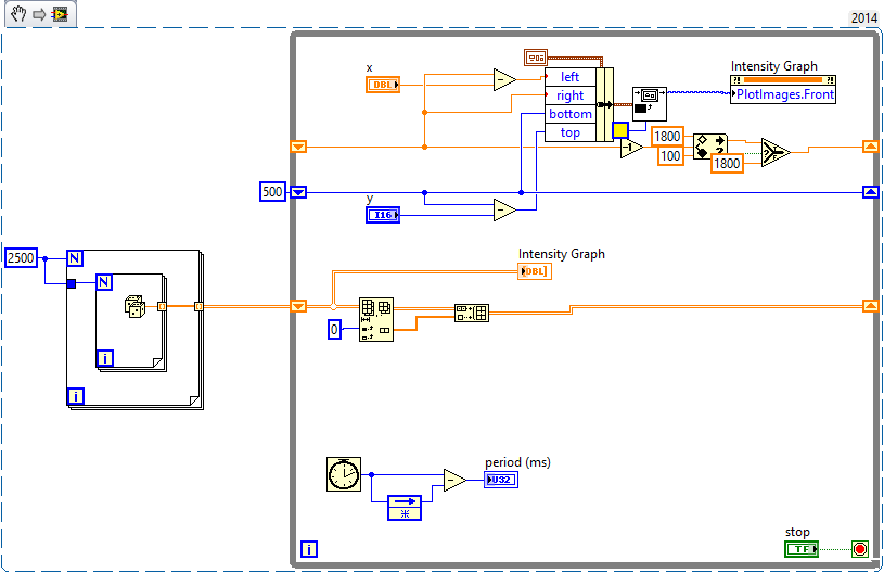

Thank you for reply.
Here my snippet.The data updates some times per second and it looks like river or waterfall. This is simulated by delete and build array.
And user can make selection. In this case the program shows the frame. And frame should swim on river with data. This simulated by Plot image property.
As you can see, the blinking presents and period ~200ms

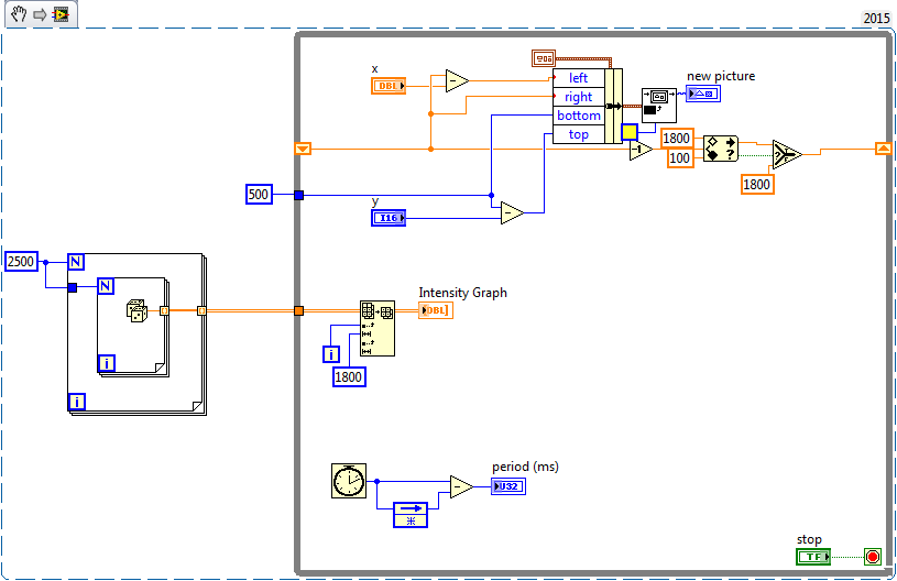

This runs at ~10ms on my machine BUT it doesn't do what you want.
I got rid of a couple shift registers and replaced the "delete from array" with an "array subset".   At that point the loop rate was ~90ms.  I then replaced the plotimages property node with a picture indicator and this brought it down to the 10ms range.  This shows that drawing the frame is not the thing that is taking the time, it is the adding of it to the intensity graph.
I tried placing a frame decoration on the front panel and moving it around using property nodes, rather than using a picture to achieve the frame.  This was actually slower than your method (~260ms).
I suspect the main issue is essentially "overlapping elements" ("plotimage and data" or "decoration and graph indicator").  I've heard somewhere that one of the more memory-intensive aspects of the front panel is calculating what is actually drawn to the screen when there are multiple indicators in the same location.  Perhaps someone with direct knowledge of this effect will chime in.
