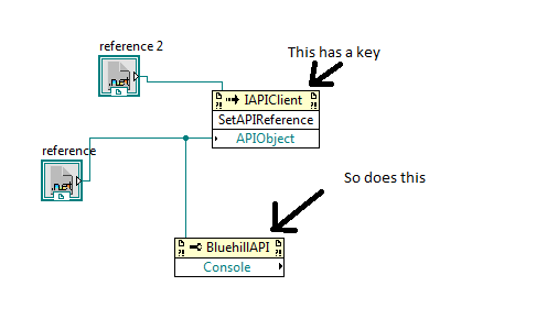

Ok, I have worked with the Null key and have gotten it so that the key is no longer null from the APIObject, which I changed to a control. I added a second node that I can hover over and see that it does have a key. However, the SetAPIReference still throws a null reference error. At this point, I am pursuing a different method of solving the problem, since all I need the API to do it send a TestStart event. I believe I can make a transducer that will read an LED of the Instron's control panel and just use that to trigger. I am still open to suggestions to get this to work via .NET.

Give us new screenshot?

Capture2.PNGHere you go. As far as I can tell, both have the same key, which I am not sure matters. Anyways, when I run it, it still throws the "Key cannot be null" error.

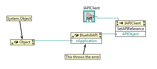

You might have to use a constructor.

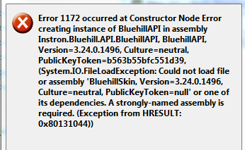

Ok, I added the constructor for BluehillAPI, which needs a System.Object Argument, so, I constructed that too. It still throws an error, but I haven't seen this one before, which is exciting.Capture3.PNGCapture3.PNG

I am linking an NI Forum post that discusses this in a bit more detail. Are you encountering this error in development mode or in an executable?
https://forums.ni.com/t5/LabVIEW/NET-Control-Error-1172-Only-in-executable/td-p/2497534

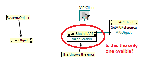

Is there any other constructor available?
Is there any examples available in other programming language?

That is the only constructor available for the BluehillAPI.

In theory, I can change the BluehillSkin.dll to be strong named, but I haven't tired it yet.

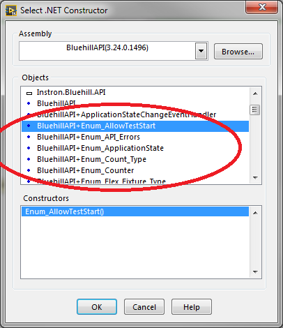

There are many constructors available in the assembly:
