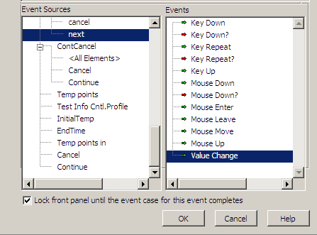

This program creates a temperature profile and it's within a much larger program where I want the user to be able to cancel, continue, go back a step, etc.  It all works fine until I leave the event structure loop and go to the verify tab.  The user should be able to continue or cancel but the buttons will not press.  I believe the event structure is locking the front panel but I turned off the lock for that case and still no go.

The answer is almost in the question, just go to the event structure and disable the option "lock front panel until event completes" 😉

Actually, I already tried to unlock the case for the "NEXT" buton but the front panel still remained locked.Smiley Mad
It turns out that it was the "mouse move" case that was locking the event structure.  The mouse must trigger the event case in the last loop cycle even after the "NEXT" button is pressed.  I would have assumed that since the "NEXT" button ends the loop the event structure would ignore any further triggers but it senses the mouse move somehow.Smiley Surprised
