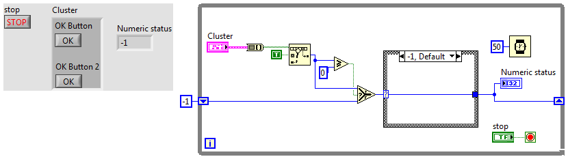

try this...use a shift register to store the value of the button pressed
(3,085 Views)
