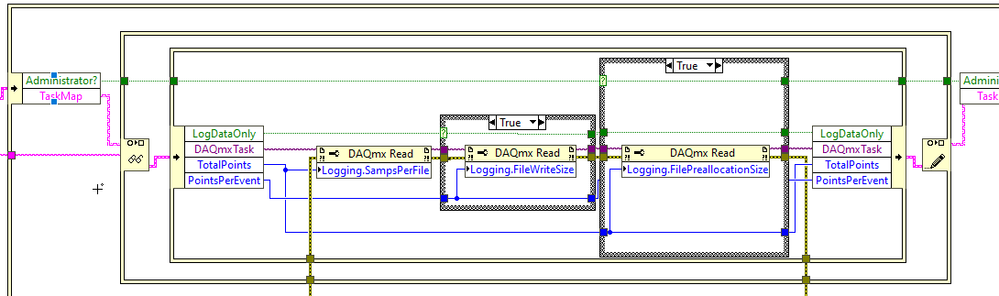

Are you using DAQmx? If so use the built in logging functions. This is the most efficient way to save data. I have saved data using it for multiple days to a week without any problems. (8 channels 2MSa/s each channel over USB)
If you need better efficiency, use the Log Only Mode; however in this mode you won't be able to monitor your signal, it will stream directly to disk. I highly suggest, (it is requirement for Log Only Mode), to have your file size a multiple of the disk sector size. Just find out the sector size and have the number of points in your file be a multiple of it. This works well for disk streaming.
Another option, if and only if your program is run as an Administrator, you can have LabVIEW pre-allocate the file. I don't know why you need to be an Admin, but you do. See messy diagram below.
mcduff
