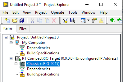

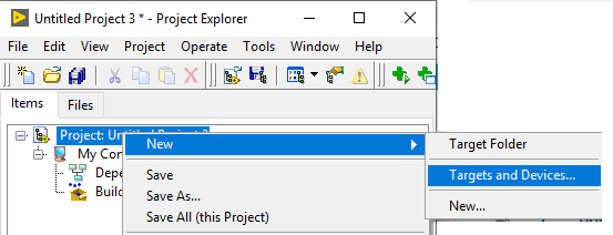

Can you send an image showing your project view containing the SCXI-1000? For example, when you add a cRIO device to a project
it appears like so:
(although you might choose to add an existing device if you had one to hand, in which case the IP address would not be unconfigured).
This allows me to add VIs directly to the cRIO target (not the "My Computer" target).
I'm not sure that it's not possible, but I haven't found any documentation that at least to me makes me think you can do the same with the SCXI chassis. How does the chassis appear in your project? (Or is it only visible via the DAQ(mx?) Channel Name blocks and similar?)
