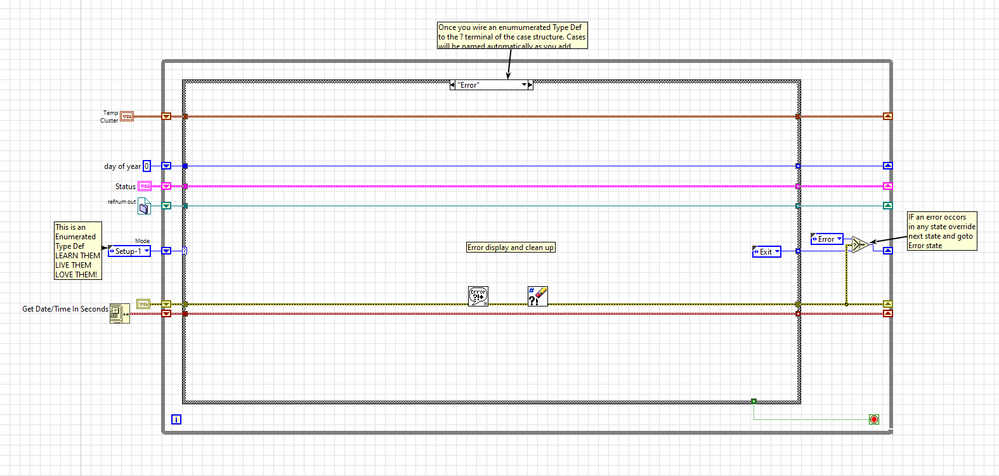

You are using a state machine (good for you) but...
  1. Learn how to use Type Def enumerated constants for your state machine
  2. Then you can give your states proper names (init, com, display, etc) not just numbers!
  3. I will attach my Simple State Machine Tutorial so you can see what I mean
