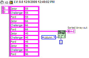

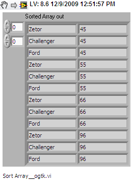

This works.  (That green thing is a Sort Array__ogtk.vi)
Message Edited by jcarmody on 12-09-2009 11:52 AM

... and if you are not fond of green, an array of clusters will sort the array based on the first element in the cluster and the second will be used to break ties. So use the cluster order to determine on which filed it get sorted.
Ben

Now I'm sure I've gone off the deep end...
Jim
