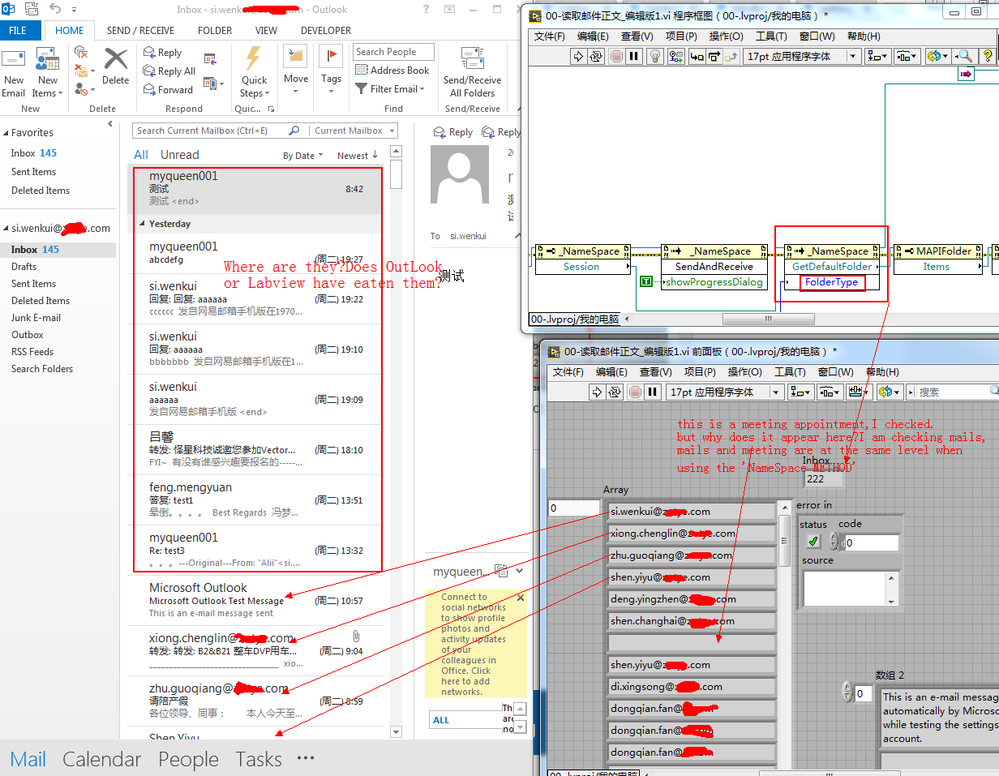

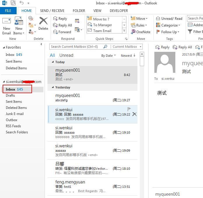

but it is still a little strange. I can see there are 145 mails in Inbox at OutLook, see as below:

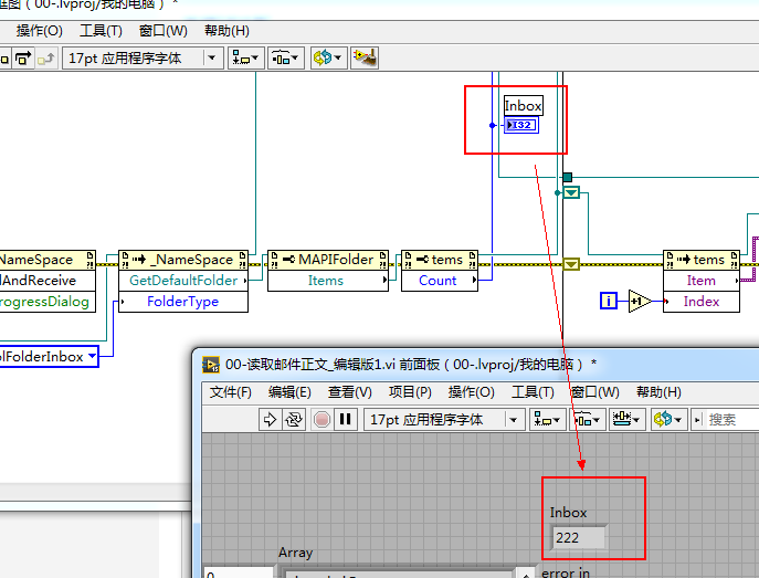

but this VI tells me there are 222mails in the Inbox,see as below:
Things worse are that , the mails list are not coressponding to the fact, the top several mails are missing,see below:

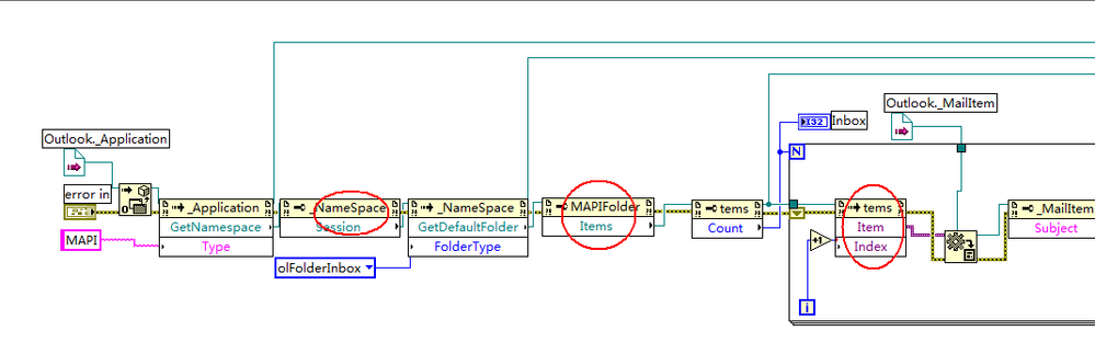

I am also puzzled with the Activex close block, from
https://forums.ni.com/t5/LabVIEW/Get-Outlook-Emails-by-Date-Received-using-ActiveX/m-p/3644303 ,
message 4,I see that ,the close block just beside the creat block. But ,from another blog
https://forums.ni.com/t5/LabVIEW/Method-of-tracking-and-closing-ActiveX-references-in-reverse/m-p/35...
it(the use of 'close') may not be so simple.

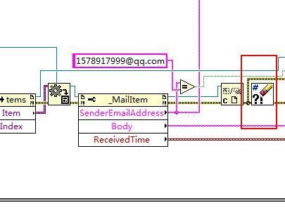

And even ,some VIs do not close the ActiveX at all ,see in the attached example, as well as in below:
So , I modified the attached when I use it ,as below:
