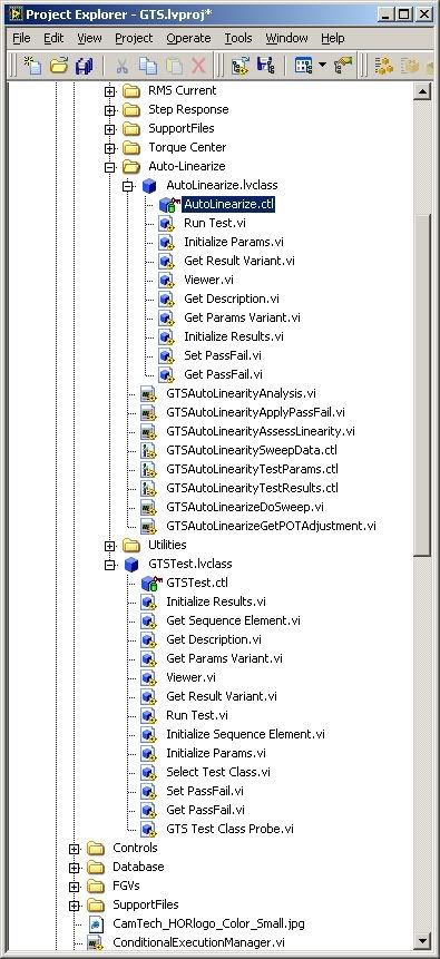

I have a large project that makes significant use of LVOOP.  It is essentially a test executive that sequences lots of different types of tests in a configurable way.  I used to use a ton of variants in and out of these tests so they could be used interchangably in the archetecture of my application, but when LVOOP came out I rewrote my test executive to us an LVOOP class called "GTSTest".  Then I have about 10 sub-classes that inherit from the "Test" class.  Each of those sub classes are the actual specific tests.  Here is a shot of the project:
You can see I am creating a main class called "GTSTest" and that gives me polymorphism of any specific kind of test like "Torque Center.lvclass" and "AutoLinearize.lvclass".  It works fantastic in the development environment.
My problem now is I can't build anything with any of the LVOOP stuff into an executable.  I originally added all the classes as dynamic vi's because some of them pop up their front panels.  An application engineer suggested taking them out of the dynamic vi's section, but that didn't make any difference.  Here is the error I am getting:

Autolinearize.ctl is the alphebetical first class's private data definition.  So what's going on?  I made all the classes dynamic and it gives me the error.  I made none of the classes dynamic and it gives me the error.  But actually I know I'm going to need at least some methods of all the classes dynamic because a couple of the methods get subpanelled in the program so I need the front panels.
I've searched everywhere and I see no documentation at all about how to build LVOOP into an executable.  But clearly you need to do something special for this to work.  Can anyone help me?
