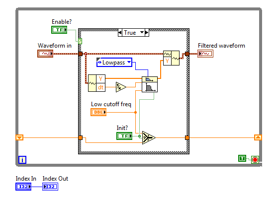

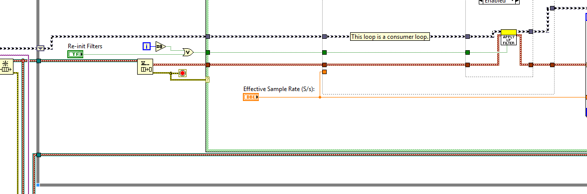

Is there anyway to verify the number of instanced "Filter Duplicates" are running? I'm still having a lot of issues with my implimentation and I'm wondering if I'm not initializing everything correctly.  I've even added a button that should push a new re-initialization.  I'm trying to have an interface that allows the user to turn off and on the filter while data is be aquired.  Here is some of my code that I'm using to try and accomplish that, but after I've enabled the filter on multiple waveforms and hit my "re-initialize" button I still get bizarre data artifacts (like spikes) that would not be indicative of data on the other side of a low pass filter.  Thanks for any additional feedback.
I've modified your Filter Duplicate to have an "Enable" feature so that the waveforms that I do not want any filtering of are just passed through.

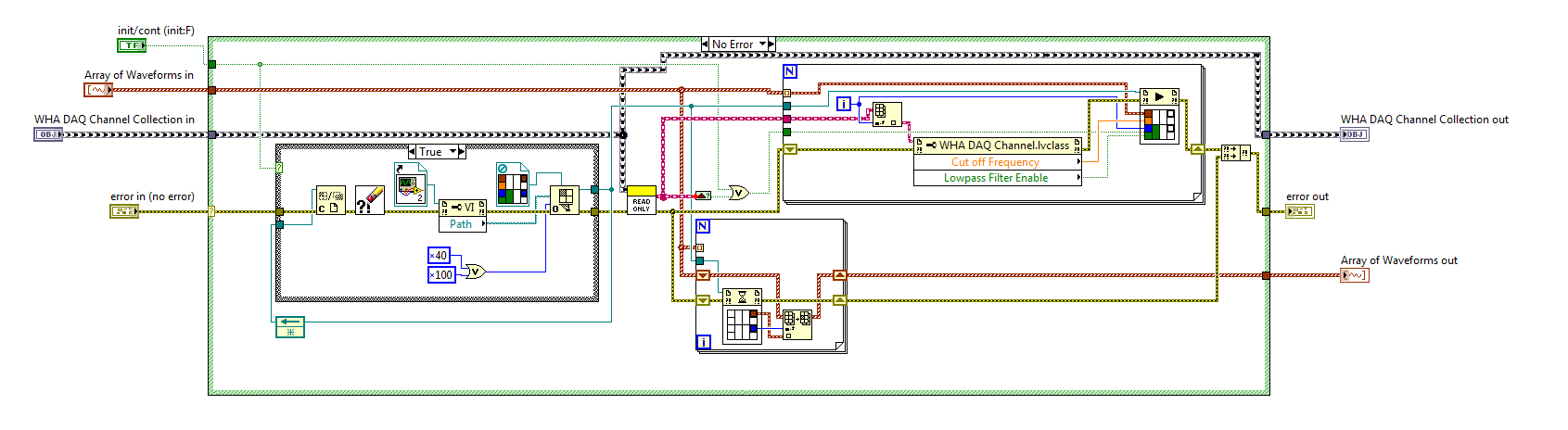

I've tried to re-create the functionality of your Test multi-filter VI Server, but with the added boolean option to not have the filter performed:

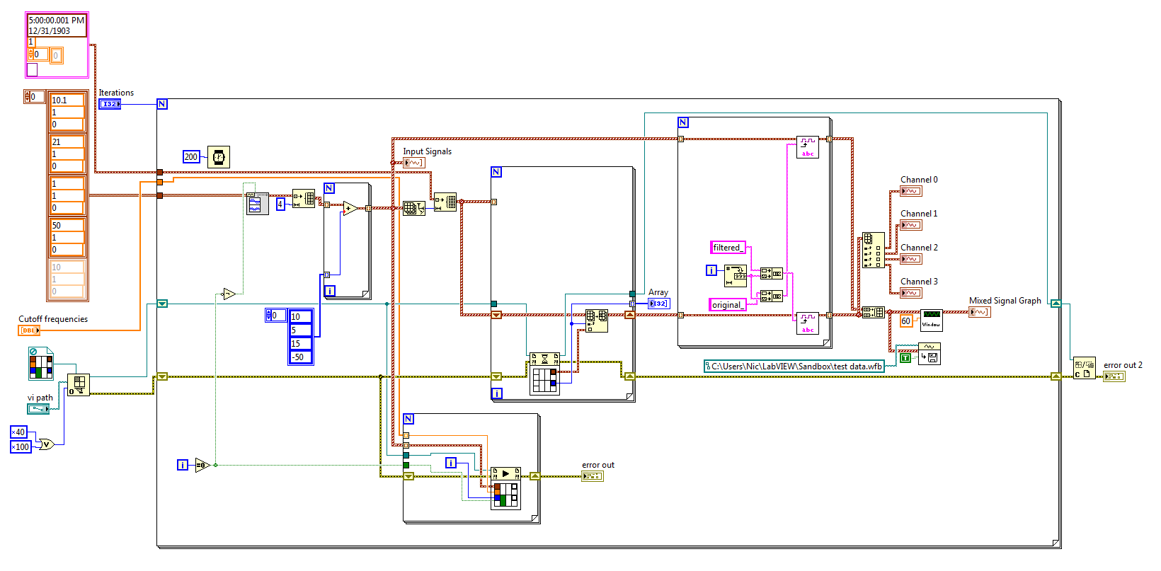

So when "True" is on init/cont input the VI is re-open by VI server and the true signal propagates to the Filter Duplicate Asynchronous call.  Here is a snippit from my main window call:

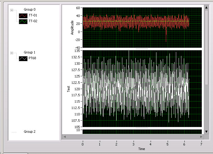

Lastly, here is the noisy data I'm dealing with:

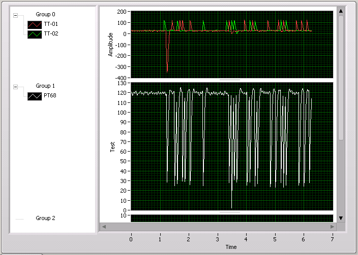

Here is the data after I apply a 5Hz filter to each one:
Clearly data from one is being imposed on the other.  Hitting my "re-initialize" button to send a "true" signal through doesn't fix it.  How can I verify that my filters are working independently as desired?

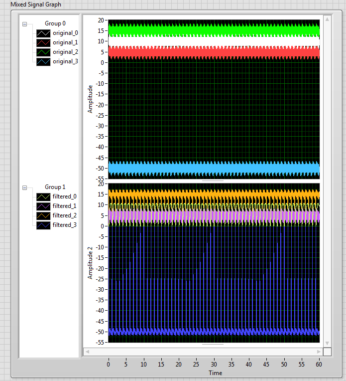

Hi Johnsold - I don't think the code you provided is working correctly.  I think it only appears to work, but it is coincidental because the input is the same regardless of which is filtered.  I'm not 100% sure about this.  What I've done is added an offset to each of the 4 input waveforms in your "Test multi-filter VI Server.vi", and my observations are consistent with what I'm receiving in my application with live data (from physical sources).
The results appear to be consistent with what I would describe as "memory scrambling" between the various calls to the filter.
Below is the modification I did to your code.  I've added different offsets to the data.  Then I've collected the data into a window for presentation on a plot.  The original signal appear just fine in my plot but the filtered appear to be suffering from "crosstalk".
