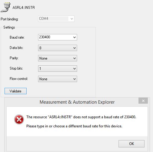

When I configure a com port in MAX to operate at 230400 baud rate, I get this error message. On the same computer, using Tera Term I can configure the same port with exactly the same information and Tera Term works fine. Please I want to find out if this is bug with MAX or I am missing something. Thanks.

Thanks for your response. Yes I can and I did but I get the same error message so I concluded that I have to get it working in MAX first.

Yes, I am using the right COM port. Same port with the same configuration works fine with Tera Term. Thanks.

Sorry, the reason I asked this is because MAX is really only reporting what the serial port is telling it.
