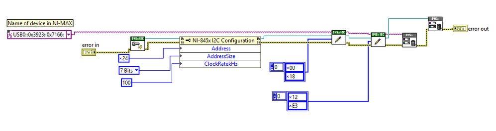

My biggest confusion is when I use the "Write.vi" I'm putting in an array and I'm assuming it's supposed to tell it the register A or B (x12) and the I/O direction (x18) but what I'm wondering is am I allowed to put two values? How does it know which value is the register and which is the data?

In an I2C write, the first value is the register and the second is the value to write to that register.  If you want to read a register, you need to use the I2C Write Read and just write the register.

Interesting, I'll trust ya cause I cant find any documentation that says that. Do you think it matters if the array is a column or a row (vertical or horizontal).

Read the documentation on your device.  It clearly states to write the register and then the value using a "Rewrite".  All that means is you write the register and then the value in a single write message (as far as the LabVIEW API is concerned).
In LabVIEW, it is just a 1D array.  There are no rows or columns.  When you get into 2D arrays, then you can worry about that stuff.

I'm completely lost with getting my code to work. I'm trying to write some data to a Port Expander (Part Number: MCP23S17) but nothing seems to work. I'm using a USB-8451 I2C module from NI to provide the controlling but i'm trying to code it in LabVIEW.
If i understand the protocol right then it is as followed:
1. Write to the correct Device & Register Address and define the I/O direction first.
2. Then write to the Device and Register Address with the actual data control.
Device Address: 0100100 (7-bit) because the LSB is R/W and the code will take care of this bit.

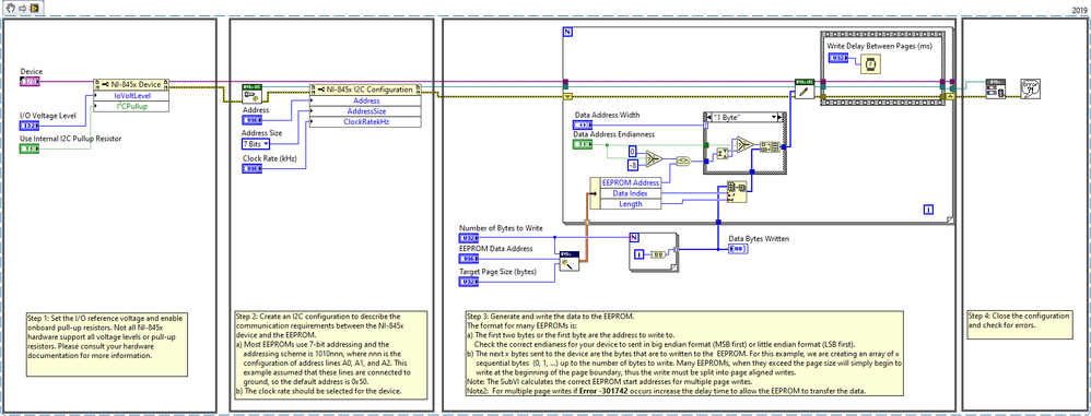

What do you mean the I2C example that ships with LabVIEW? How can I get this?
Go to Help, Find Examples.  In the "Search" option, type I2C.  Click on what it finds.  I've attached the 2019 845x "General I2C Write" VI as a Snippet -- it has no "hidden states", so you should be able to manually reproduce it.  I've never used I2C (but have used the SPI examples, and "think I understand SPI"), so I can't offer much additional help (like why there are references to EEPROMs).  Some of the other examples might be more appropriate.  I'll note that writing code for the SPI version of your chip was pretty straight-forward.
