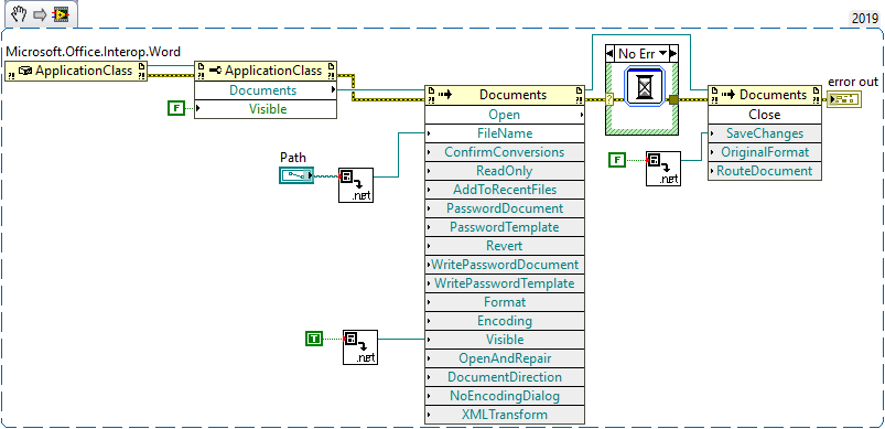

I guess it shouldn't be too hard to remake it at .NET (as it should be). This quick attempt didn't quite work though.

Thank you everyone for the good replies. I will explore the option of calling the .NET framework. It looks like you need to install Visual Studio to access the ‘Microsoft.Office.Interop.Word.dll’. Unfortunately, I don’t have time to explore the solution right now.
(2,891 Views)
I don't have Visual Studio. I do have Office though.
