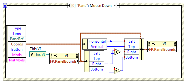

I have a popup window with no toolbar.  I'd like to be able to drag it around the screen, but am having issues coming up with a good way..
I think using a mouse-down event on the pane is good, but I can't come up with a way to set the windows cordinates. Have any ideas?

I think I can get you started, clearly there is more to do but you get the idea...  I put this together for you to demonstrate:
Hope it helps!

Thanks, great start!  I think some code from this demo will finish it off -

So, its draging, but has the shakes 🙂  Also, it doesn't quite keep up with the mouse. Are the increments that the mouse uses different than the fp.bounds increments?
Check out this vi. Do you have any ideas on smoothing out the shakes?

I remember doing this a long time ago, i think the mouse coords are relative to the pane so you'll need to set the same offset each time.
