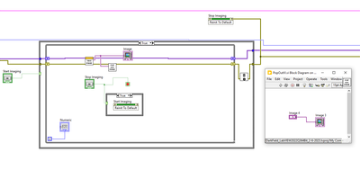

Thank you for that suggestion. I had tried that multiple times in the past, however the image is not popped out into a separate window. In fact, the VI executes every iteration of my while loop based on probing, but does not actually open a new window. Any ideas how to solve this?
I have attached a screen shot of the portion of my code that is affected. The TakeImage.vi is tied to licensed software so I cannot share the larger VI for debugging.

When setting a VI to reentrant mode, LV should create a copy every time you run it. But be careful!
(1,704 Views)
How do you set that mode?
(1,683 Views)
Under VI properties (Window Appearance >> Customize) you can set the VI to "open when called". If the "close when completed" is also checked, you'll want to uncheck that. It is nice for a normal pop-up, but for something that executes very quickly like this image updater, it will result in a flashing appearance.
