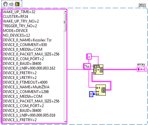

For example you could read the file, skipping the first line, into a string.
Use string to array function to have a 2D array with keys in the first column and values in the second column:
Marco
(3,137 Views)
Thanks a lot, very simple.
Božidar
