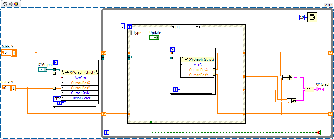

How about this? The downside is having to create a finite number of cursors for your graph to begin with.
1. Create initial plot XY data. Cycle through the corresponding cursors and set their positions.
2. Allow dragging of the cursors. On timeout of the event structure, replot the 'new plot' line between cursor positions.
3. On pressing update, set the main plot data equal to the cursors positions.
LV2012 example attached.

That's' brilliant
Just the sort of thing I was looking for
I don't think I would have ever have got there on my own. I was thinking of changing the limit points by updating an array on my front panel but this is infinitely better.

The downsides with this (that I can think of anyway) include having to manually create a fixed number of cursors to begin with, and the ability to drag a point to a lower X value than the previous point in the array. The latter is soluble with a bit of work (allow dragging in Y only, and only update the Y axis for each point etc), but I can't think of a way around the former at the moment.
