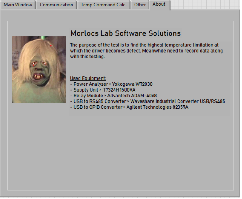

1. Software is used to test and find the highest temperature limitation at which the driver becomes defect. Meanwhile need to record data along with this testing.
2. Used Equipment:
- Power Analyzer > Yokogawa WT2030
- Supply Unit > IT7324H 1500VA
- Relay Module > Advantech ADAM-4068
- USB to RS485 Converter > Waveshare Industrial Converter USB/RS485
- USB to GPIB Converter > Agilent Technologies 82357A

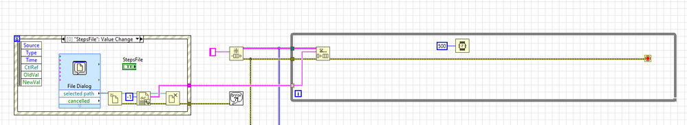

1) How do you expect this to work when your Event Structure is not inside the While Loop?

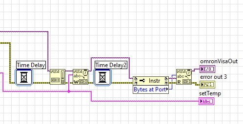

2) Don't use "Bytes at Port"!
I recommend this video: VIWeek 2020/Proper way to communicate over serial

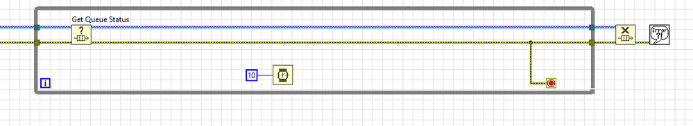

3) What does this loop do? (Besides release the Queue if there is an error?)
There are much better ways of doing this.
4) Configure Serial Port being outside the Loop is not the best way as if your setup changes from the saved defaults, the program will abort when you start it (or at least try to) and you will have to try to restart it after any changes without closing it, or the defaults will just be reloaded when you open it again.
Consider putting the Configure Serial Port in a "Configure" state that can be called without exiting and restarting your program.

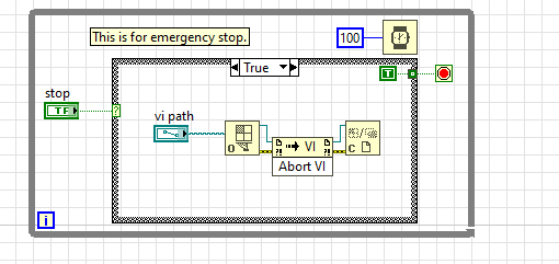

5) Your Emergency Stop just closes your program and nothing else!
Shouldn't you shutdown your instruments and maybe your OVEN(!) in case of an emergency?
Also how do you plan on stopping this loop at the end of your program?
In fact you have several parallel While Loops running with no way to stop them.
There's probably more going on here, unless I am missing something I don't think this program works at all.

1) Already changed this using loop and "stop" function (also all instruments before that are going to disabled mode)
2) OK! I will study this...
3) Nothing more I just used this pattern from NI Help.
4) Good point, thanks I will change that.
5) Answered in pt. 1
Program will be stopped using stepfile and I will add case where will be function to spot whole application. Therer is need to have possibility to stop the all seperatly? I can do this using stop button. I assure that program works but still there are things need to be corrected.
