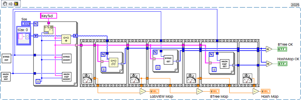

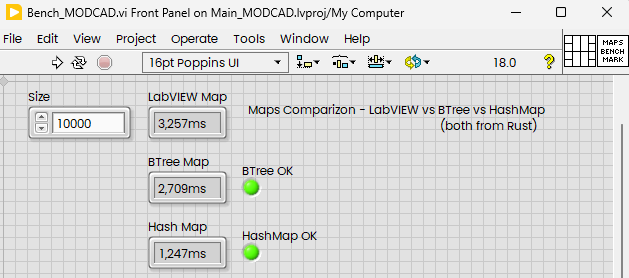

Yes, I agree. By the way, I'm positively impressed with the performance of the maps in LV. Just for fun, I tested maps from Rust (both HashMap and BTree), and yes, they are faster than LabVIEW, but not dramatically:
Code used for benchmark:
Spoiler

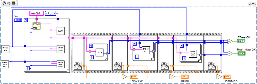

Sorry, I forgot about the overhead caused by functional globals. Additionally, Maps were introduced in LabVIEW 2019. Below is the correct comparison:

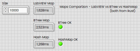

And the results — the performance of LabVIEW Maps (for the given data) is somewhere between HashMap and BTree:

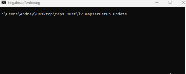

To compile Rust code, you need to install the latest version of Rust (or update your existing version), then build it as shown below:
rustup update
cargo build -r
