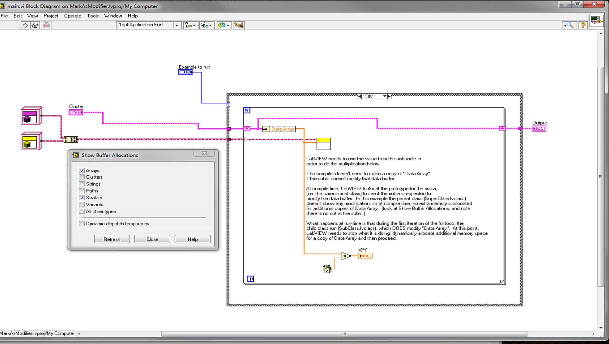

After further digging, (see this link : http://forums.ni.com/t5/LabVIEW/Threading-and-Re-Use-of-buffers-Using-Call-By-Reference-node/m-p/150...) and talking with NI , I think the appropriate example is the one attached.  Here are screenshots of main.vi :
Example of not using the in place structure with "Mark as Modified" :
OK example
Example using In Place structure with "Mark as Modified :
Better
