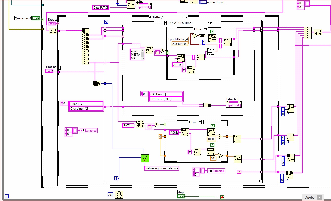

Hello Everybody,
I used the latest example of marquee for For-loops and it works nice only once! After calling it for a second time, the marquee window pops up but the marquee is from the beginning and stay at 100%, no matter of the for-loop iteration until last for loop iteration has been acheved, then the marquee window closes normaly. What should i do in order to get the marquee bar growing even after the second call of it?
First call - everytrhing works fine:
Second call - Marquee is 100% from the beginnng until the end:
Source - how i call it:
Hope somebody can halp,
Thank you
Sacha
