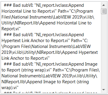

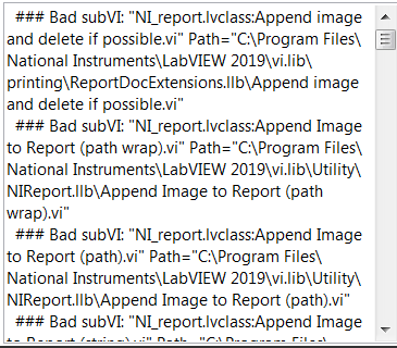

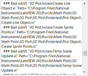

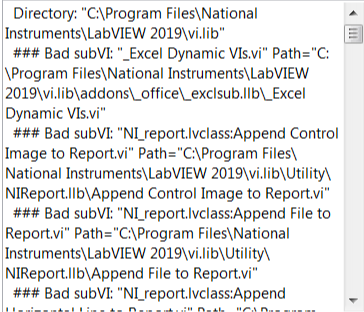

Here are few of the errors:

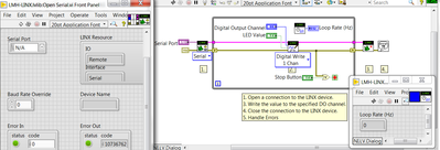

For example, the issue for my block diagram specificity seems to be the ''Loop Frequency'', which is also the ''bad subVI'' and the only one that also can not be run from the Block Diagram. But it is in the same folder as everything else that is running. What could be the issue here...
With this image, it looks like you accidentally crossed wires (the stop button control and the error out of the subVI are wired together).  So you should try re-wiring your OR function.

Oh, did not notice. I apparently messed it up just for the photo, but other than that I have all the same problems.
This photo shows more accurate situation:
I opened Open Serial Panel for comparison (of arrows).

@crossrulz wrote:
That should actually work in relatively recent versions of LabVIEW (I want to say LV 2010 or so).  Occasionally I see it fail.  I think you need to do it in a specific order for it to work.
