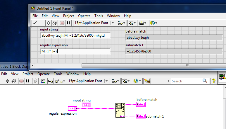

I tried your test string again and the output worked out OK.  Could you post some example(s) of when it fails ?
(4,129 Views)
Hi 🙂
I realized that if I use match regular expression instead of match patter, the code "M: ([^ ]+)" works perfectly.
